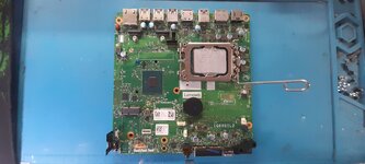

Lenovo ThinkCentre M70q Gen 3 Model for BIS: 11Y5
S/N: MZ01MWSE Machine Type: 11Y5
Motherboard: HB660 NM-D861 Rev: 1.0
Issue: Recovery Mode
Request: Bios Bin File (Full Bios Bin File & ME Region)
Attached Files: Orig Bios Bin File & Motherboard/Model Number
Thank you :)
Thank you :)

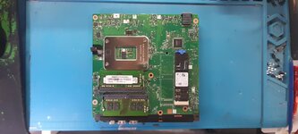

good day sir
i tried flashing the bios bin file but i encounter error. 2 different bios programmer and the same error.
i can backup the orig bios bin but i can't write the bios bin file you send
please advice for best bios programmer or need to replace the bios chip
thank you sir :)
it seems the bios file is OK
i cant suggest any progrmmer but you can check the bios chip first in case it might have faulty
